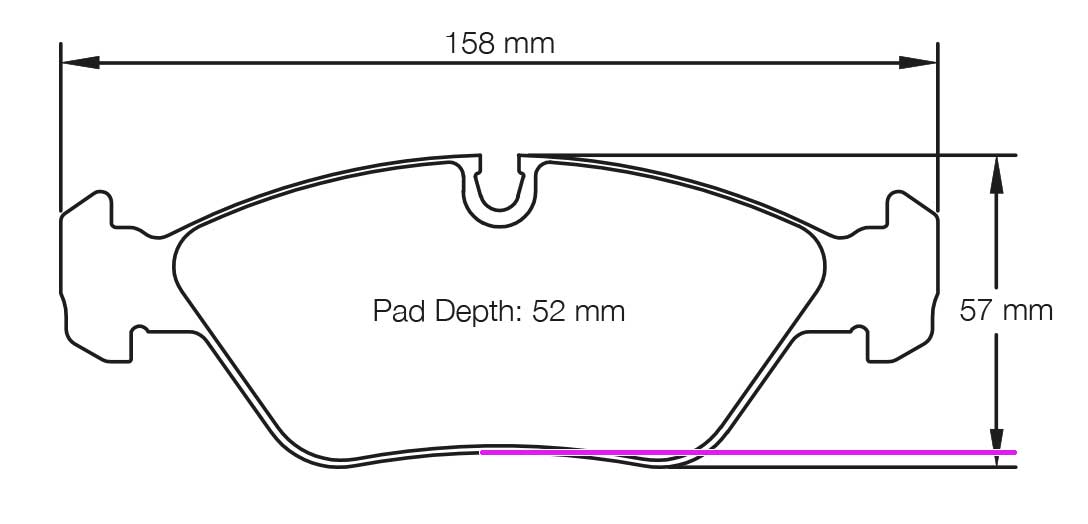

                The pistons are installed in the calipers, so I'm measuring at the leading edge that is projecting ~5mm past the dust seals. Not sure why I'm seeing 1mm less than what you have for dimensions as there is no taper cut into them as far as I know.
                According to this page from Pagid the front pads are 57mm measured from the backing plate, so your measurement of 55mm for pad material makes sense, and further confirms your estimate.
                I think that Pagid measurement is correct but whoever did the drawing made a mistake. They show the measurement at the thickest points but it should be showing the true radius, which would put the bottom point at the center of the bottom of the backing plate, if that makes sense. ...but then they show the pad depth at 52mm which is confusing.
                Edit: this page shows the PFC pad depth at 52mm, so maybe 52 is correct after all.
