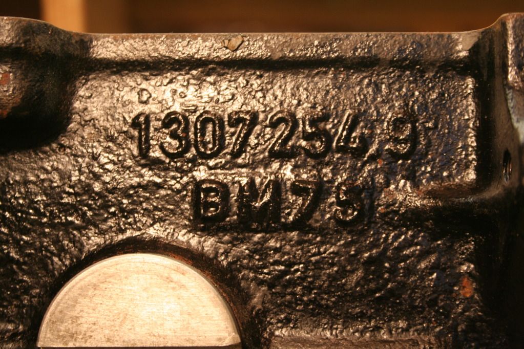

    I'm going through my hoard and I'll never use this, although it would make a rather expensive coffee table with a sheet of glass fitted. Someone on here may want it.

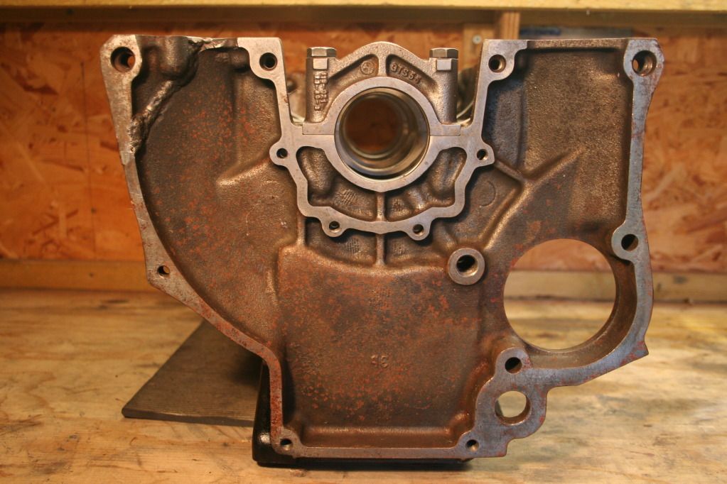

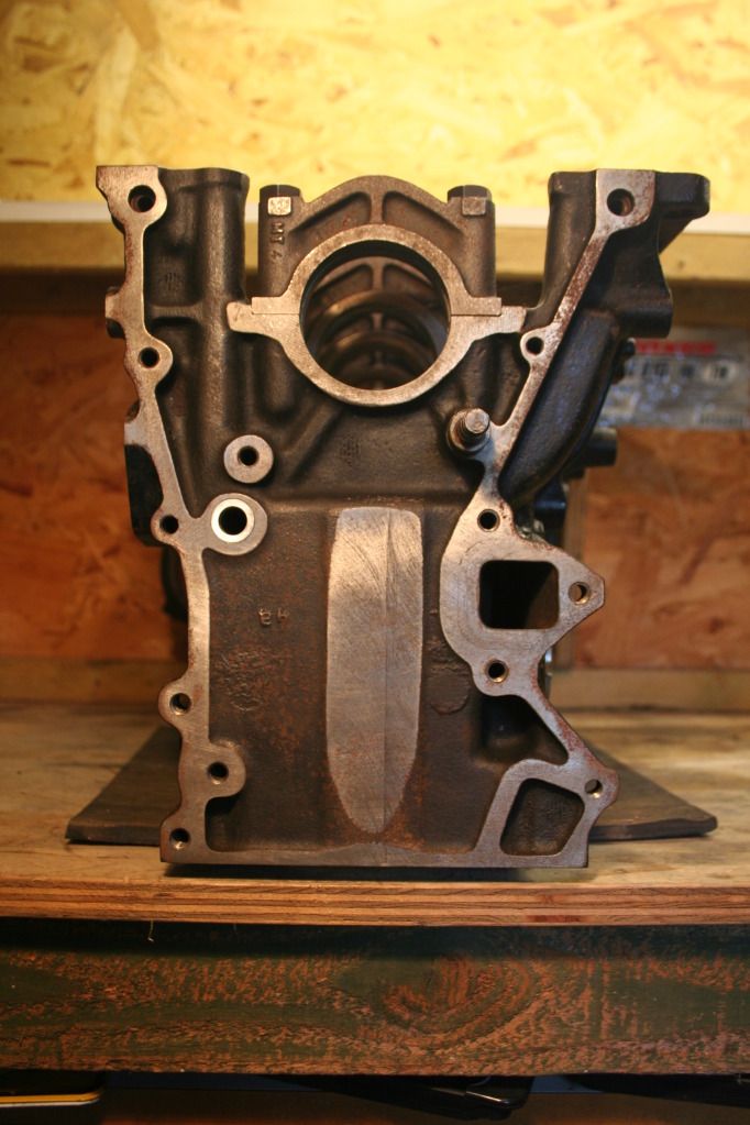

    Left over from a load of other S14 parts I bought. This is a proper 2.5 block, not a bored 2.3. Bores are not oval etc.
    I've passed it onto a close friend who works for a reputable engine reconditioner to check it over for piece of mind.

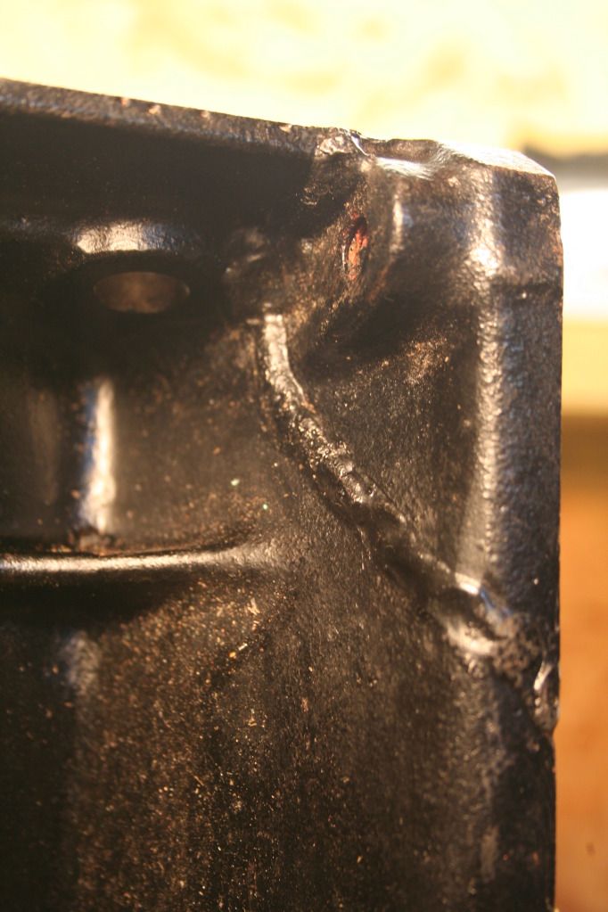

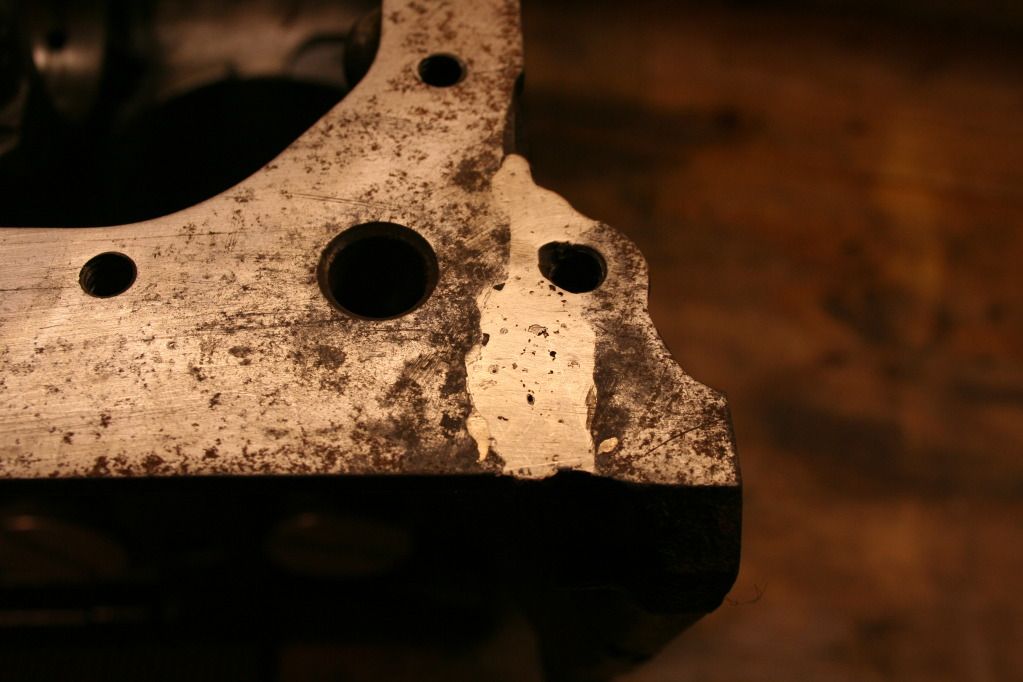

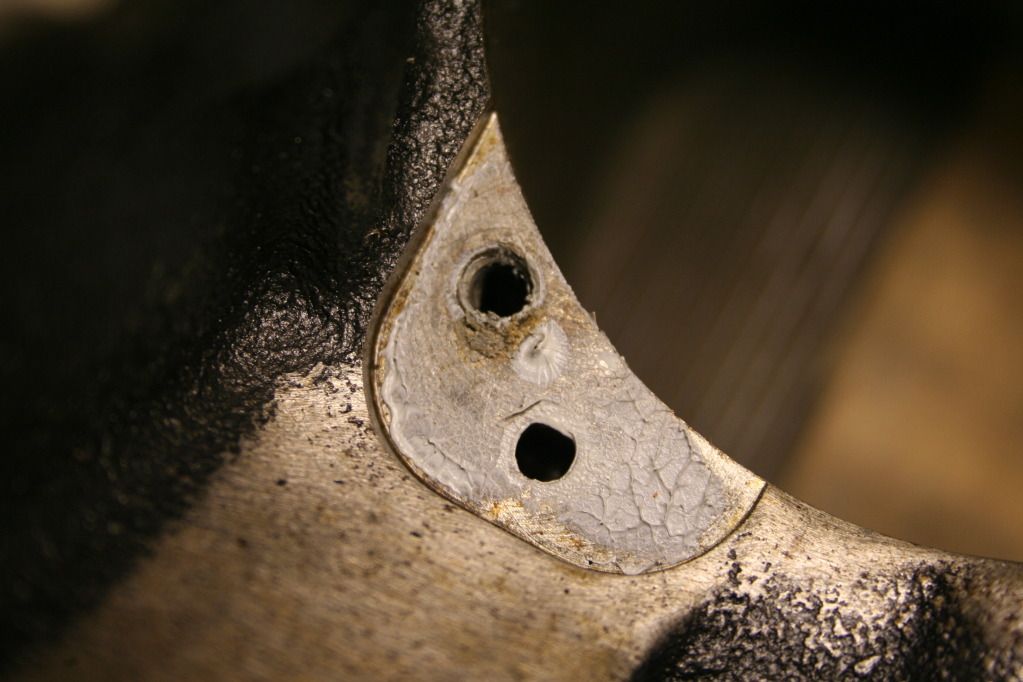

    It's had a repair, detailed in the last photo's.

    I'm guessing a flying rod caused the damage?
        Not a clue I'm afraid, it's as I bought it.
          A flying rod does not cause that. The car it was in probably took a hit and cracked the bell housing. Not uncommon and completely repairable.

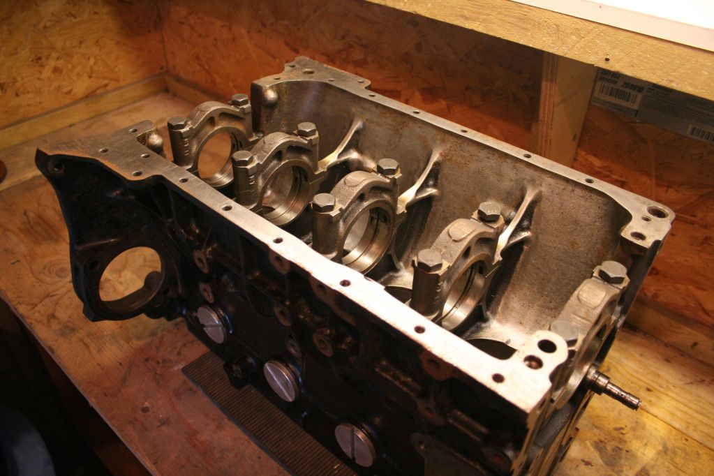

          That's an interesting block Dan. Someone has prepared it to a high spec at some point. Nobody stress relieves the crank case like that for fun.

            Thanks for help again Jake, even though you're accross the pond I still manage to pester you. I had wondered of the blocks origin, race car??? forced induction???

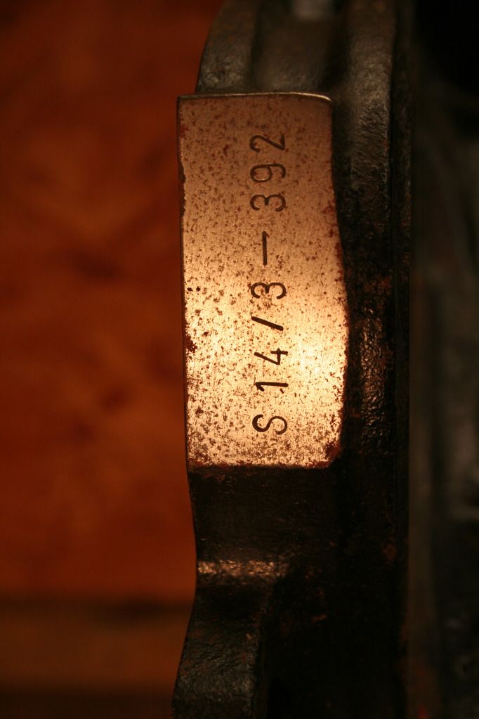

                    Someone? I think, BMW MS has prepared it. S14/3 is a 2,5l ´90 DTM-block. Based on the early E3 Block. Later, they use stiffer main bearings.
                    For a high end S14 it is better to use a prepared late E3 Block, or the late DTM/Gr.A Block ( new >4500€)

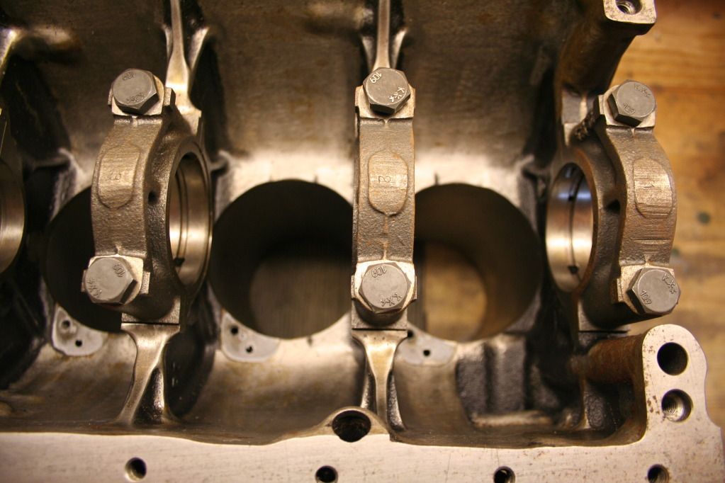

                    What is the exact bore dimension?

                        I have measured the bores with some old verniers and they all come to 95.8mm. The block is with the engine specialist at the moment as I have asked him to check it over plus double check my measurements etc.
