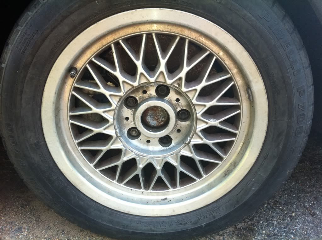

    This is a very nice set of BBS RG, staggered 16"x7.5" et20 and 16"x8.5" et24, 5x120. Rear wheels have a slightly larger lip. There is no curb rash on this set and no bends or damage of any kind. They are a little dirty in the pics and the paint is faded. They should be painted or powder coated to be perfect. No center caps, tires are old and will be removed. $800 plus shipping.

      These may not be RG's. I had this issue when I was buying what were thought to be RG's.
      The 5x120 16x7.5/8.5 BBS RZ's had the same shape as the RG005/006 unlike all the other RZ's
      RG's only came with platinum color centers, not silver or gold.
      If these are RG's, they will say "GESCHMEDET" (translates to forged I believe) and RG005 under the center cap. If they are RZ323's they will say 323 and weigh about 19lb instead of 16lb. Same goes for RG006/RZ324
      Note in the below catalog page, even though they switched the RZ and RA labels, the RZ at the top right looks like your wheels.
      This is the platinum color that RG's came in
        Those are definitely forged RGs. Take a look at his wheels and the ones you pictured as a comparison. The main difference between the 16" RZ and the 16" RZ is the way the lip meets the centers.
        As you can see, his wheels have the same little lip (the area beneath the mesh design) between the wheel's center and the horizontal lip.
        The RZ's mesh center spokes go all the way to the edge of the lip and the center.

          Not true. Unlike almost every other RZ, 16x7.5/8.5 5x120 RZ's have the exact same shape as 16" 5x120 RG's. look at my post above. The wheel in the upper right of the first image is an RZ. the second image is an RG. E38 RZ's also have a different lip than most RZ's
          I have RZ 323's and they look exactly the same as OP's wheels. Mine are definitely not forged and definitely not 16lb. I believe I see the number 323 on the center of the wheel in OP's second pic.
            Good eye!
            Ok, now i'm confused... The front wheels are stamped 323, and the rear wheels are stamped 324. So these are cast RZ323 & RZ324?
            Wasn't trying to misrepresent the wheels, they came on an e24 m6 I just bought and I didn't know exactly what they were.
              Originally posted by Shane Snyder View Post
              Good eye!
              Correct. These are cast RZ323's and RZ324's. Didn't think you were trying to misrepresent. These are confusing wheels (visually identical other than color). Very few RG005/RG006's exist because of their cost when new. I have been looking for a set for a long time now.
