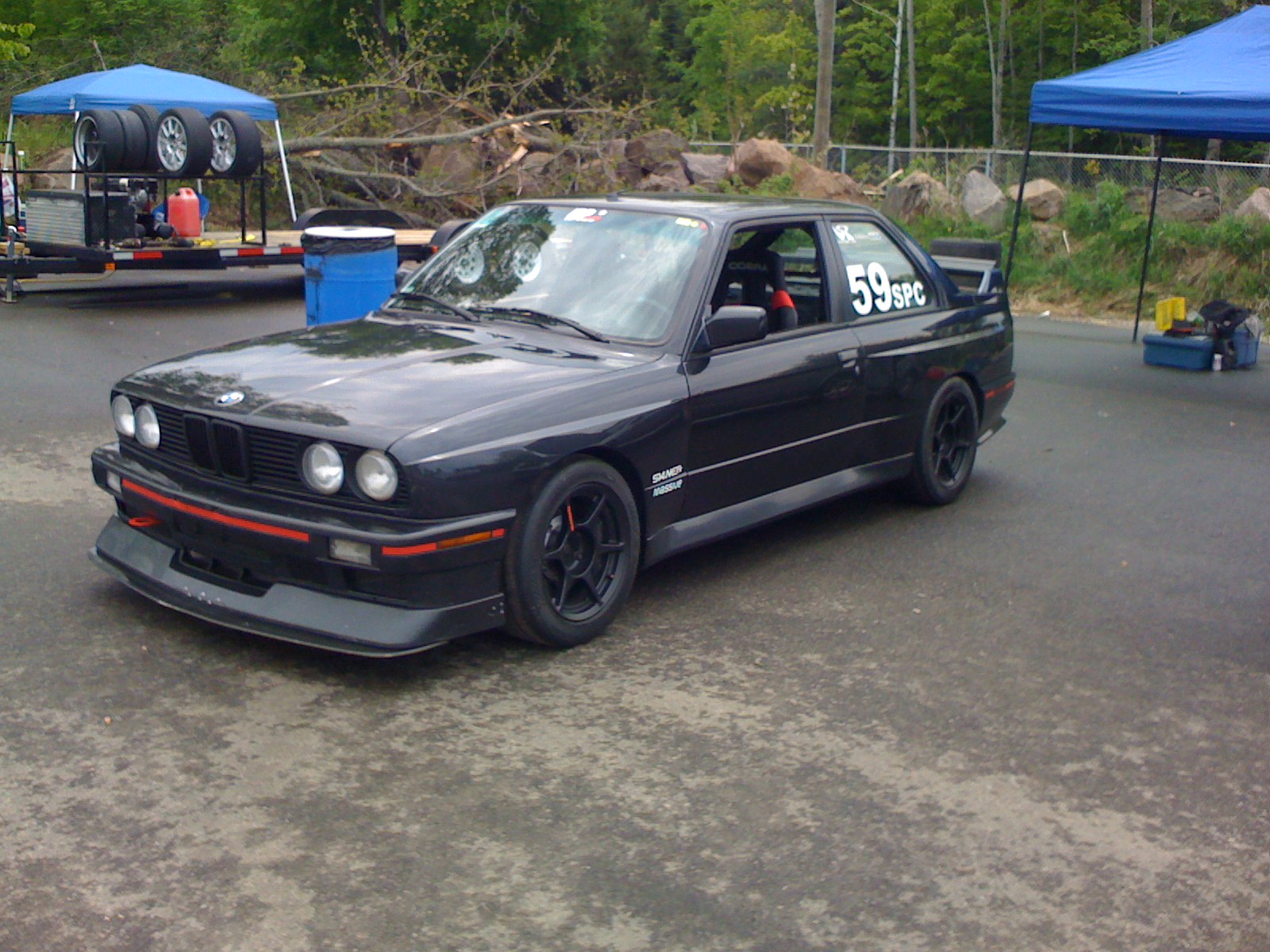

    It's long overdue but I finally removed my heavy, and probably useless, "EVO 5" style splitter. I installed it 13 years ago and I must have had 2lbs of fasteners holding it on.
    I'm not sure what I'm going to replace it with yet. As I understand it, it's just as important to have the splitter extend under the car as it is to project in front. Unless there's a good solution out there It seems like I'll have to make my own.
    Any suggestions, recommendations, humorous anecdotes?
    Pic of the old E5 splitter
