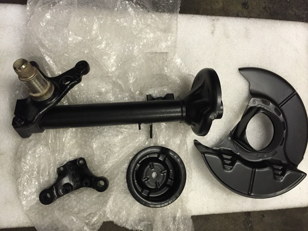

    So work commenced pretty much straight away and first thing to be tackled was the suspension because it was so stiff and uncomfortable to drive on the road.
    New front brake back plates were bought and those along with the front struts were blasted and power coated satin black.
    Four new Bilstein B8 shocks and eibach pro kit springs (same as what was on the white M3 and my 325i Sport) were ordered up as well as a pair of new wishbones, eccentric wishbone bushes, camber correction top mounts, E46 convertible rear top mounts, Z3 reinforcement plates, front drop links, and a set of new unused eibach adjustable roll bars sourced from Kos were fitted which has transformed the way the car rides and handles compared to what was on before.

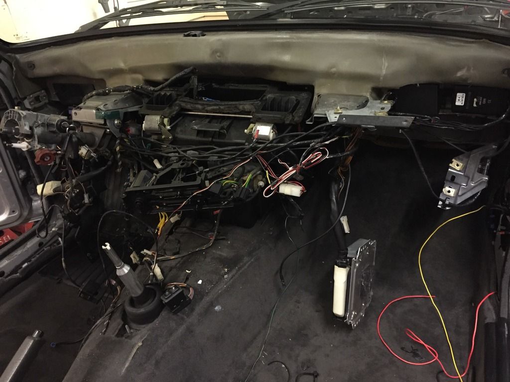

    The red dashboard removed and the bulkhead inspected as much as could be with with no signs of rot or dampness. Some rectification work was required to the alarm wiring and a minty mint black dash from Paul Z3I was fitted.

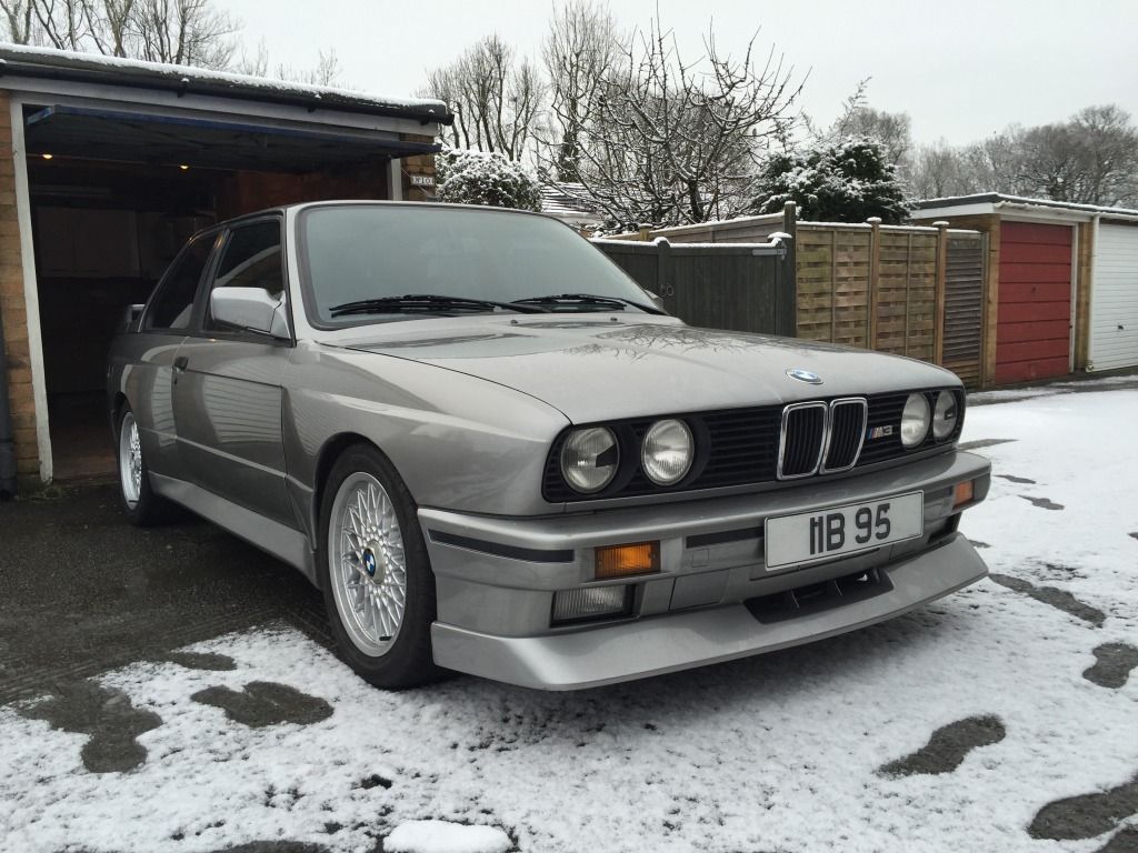

                      A recent pic of it parked up at work.
