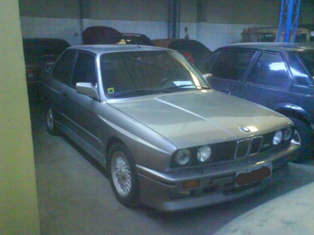

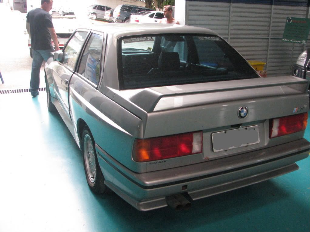

    Last November we had an oportunity to buy an M3 e30 at a bank auction. We battled a guy who after claimed having a mercedes 190e evo, i don't know if it was true , as i've never seen one here in brazil.

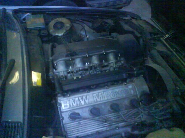

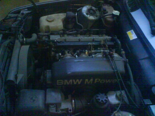

    We got the car and it was not in its best shape suspension and engine wise. After we dismantled the engine we saw that for the long term it was better to do a rebuild and start fresh. Yes , we took right of the bat the 2.5L route...
    I have the luck to know and be friends with an engine builder who is an expert in bmw engines...

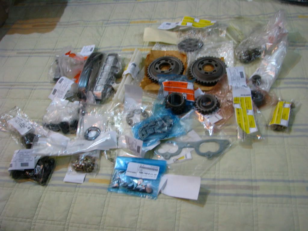

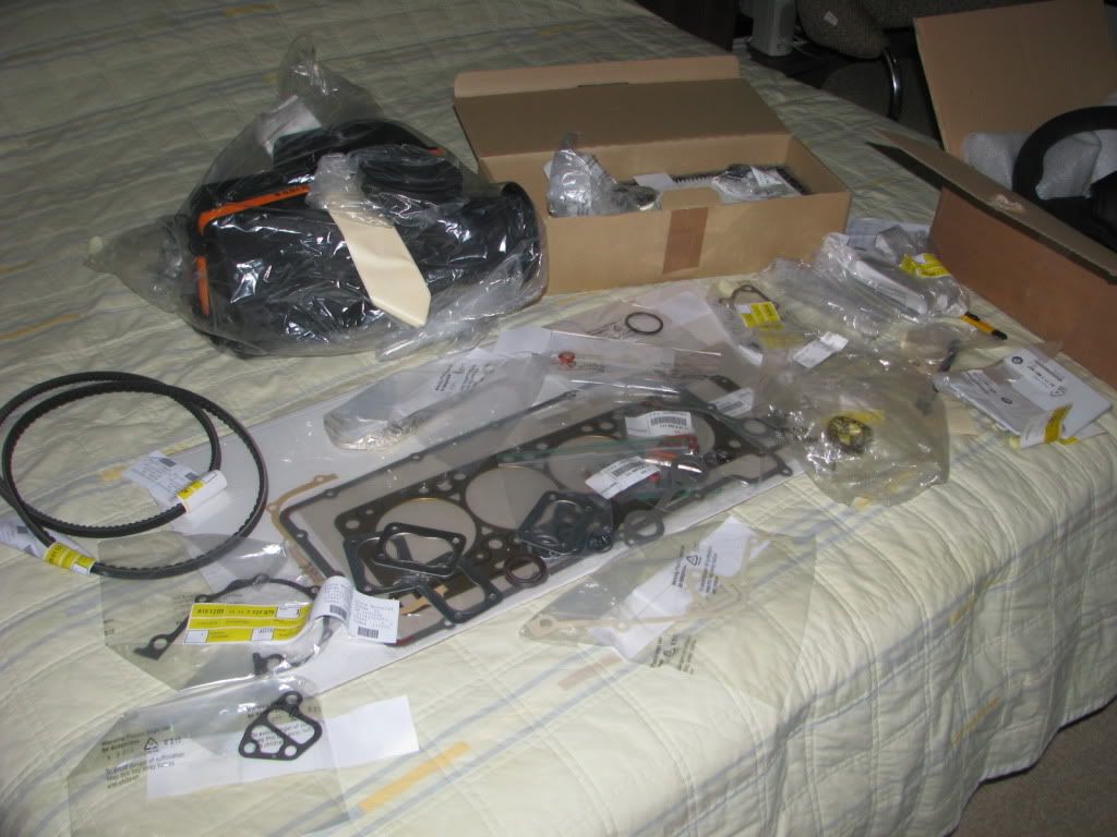

    I had to get a new cilinder head , as the old one was skimmed to the maximum and had it reworked for better air flow. We also got new pistons from JE, a 2.5L crank , evo oil pump, oil baffle, all gaskets, water pump, all new valve train in the engine (chains guides, chains, tensioner from e36m3, etc) , evo intake , new upgraded valve springs , bigger valves from the s38 engine , etc etc...

    The car as i found it at the warehouse:

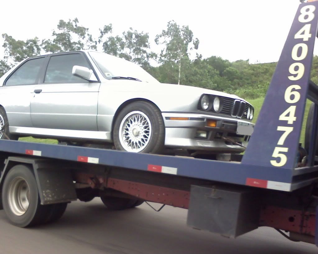

    Going home ! (the auction was about 2000 km from home !)

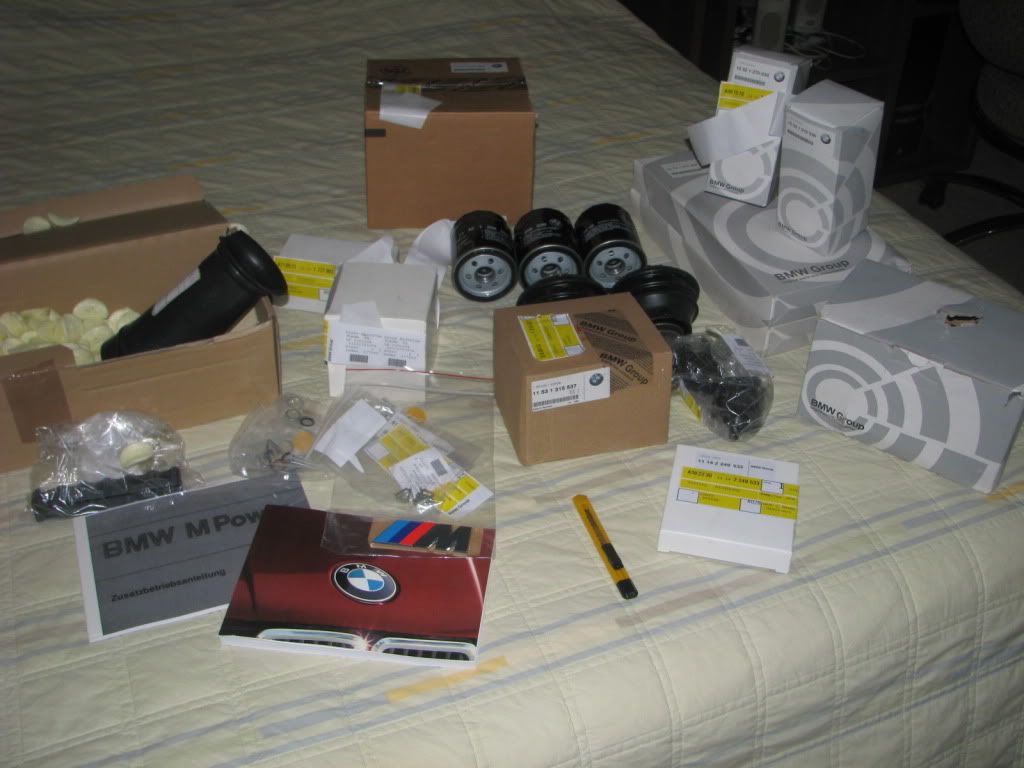

    German Delivery !!

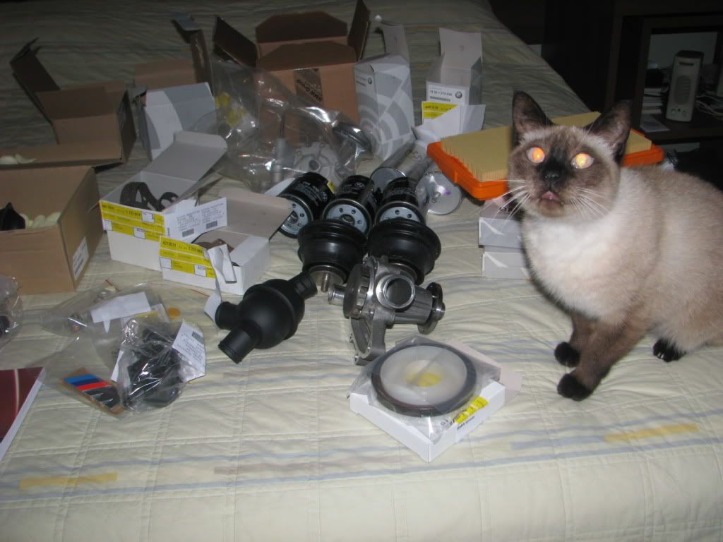

    the cat only speaks portuguese, hehehe : (///M Threeeeee!)

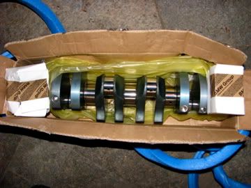

    evo crank:

    valve train:

    It looks like a lot of packages are being delivered
    Looks like you're making some real nice improvements!
    Keep the posts coming.
      Very Nice and Keep us Posted
