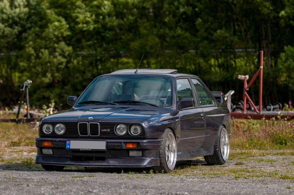

    Is there some way to adjust the alignment of the front bumper? I've had it of and checked both the plastic and steel mounts, and they look fine. The plastic tabs on the bumper that holds the mount in place doesn't seem to be out of place either.. But still it looks like its sagging at the rear towards the wheel-arc.
    Hope anyone can help. Adding a pic so you can see what I mean. And yes.. ..it need new paint.. :/
    Have you tried re-tightening the front bumper with it held in the proper position?
      that and also the alignment blocks on the side, i had to play with mine and elongate some of the mounting holes to get it to tuck nice and tight..
        What color is the car in the picture above?? also let me know if you have any luck fixing the bumper sag i have same problem
