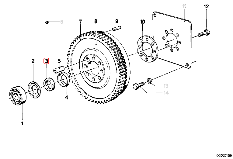

    So I have my 2.5 back from the machine shop and I am starting assembly.
    I have a question regarding the rear of the crank. I have noticed an odd felt ring assembly pressed in front of the spigot bearing. On realoem it shows it goes in front of the spigot bearing.
    It looks to be NLA. Is this necessary? Can I remove it and just use the spigot bearing like any other engine?
    01Grooved ball bearing12X32X10111211709681$17.67
    01Grooved ball bearing111211709934
    02Covering plate111211744345$3.92
    03FELTRING111211744601$0.87ENDED
    04Covering cap111211744342$1.18
    05DowelD=14,5MM111111743118$1.65
    07GEAR RIMZ=116111221270080ENDED
    08Flywheel111221311862$440.70
    09Dowel pin311221744338$7.48
    10Shim111221262827$32.37
    12Hex boltM12X1,5X22811220616143$3.77

      I've always assembled them like you have it.

        Just get a pilot bearing that has a seal in it and forget about that felt ring, since it's obsolete technology.
        Larryi
          Yep no need for a felt ring since the new bearings have a rubber seal.
            OK thanks guys. Will pull this out and fit a new sealed bearing.
