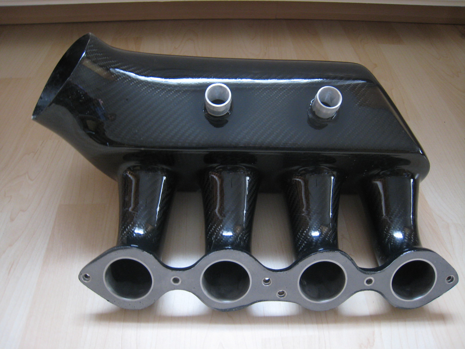

      if you are using the original master brake cylinder you'll need a slightly different Airbox (on the underside) then the "normal" S14 one
      Airbox for 2002

          I believe he meant brake BOOSTER. not MASTER CYL. You need a tii booster. And that is for the 2002 specific airbox.

            What if he wants to run the larger airbox? Is this possible?
              nope. not unless the brake system is changed to delete the booster entirely.
              that is why there is an airbox made that is specific to the 2002......

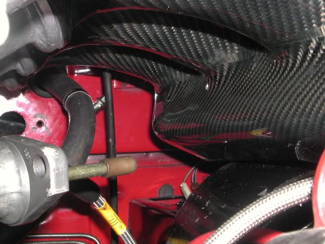

                this is how close the 2002 specific airbox sits to a tii booster. normal e30 airbox ain't gonna work.

                  Ok.... where can he buy the 2002 specific airbox?
                  does it work with his existing Alpha n ?
                    it will work with his specific alpha N. He should contact John in Germany for the airbox (probably who he bought the Alpha N from) or Motorsport concepts who also sells those products. Either way, it all goes through John.
                    It's possible that Markus on this forum has that airbox as well, he's very responsive, it's worth sending him a PM to check

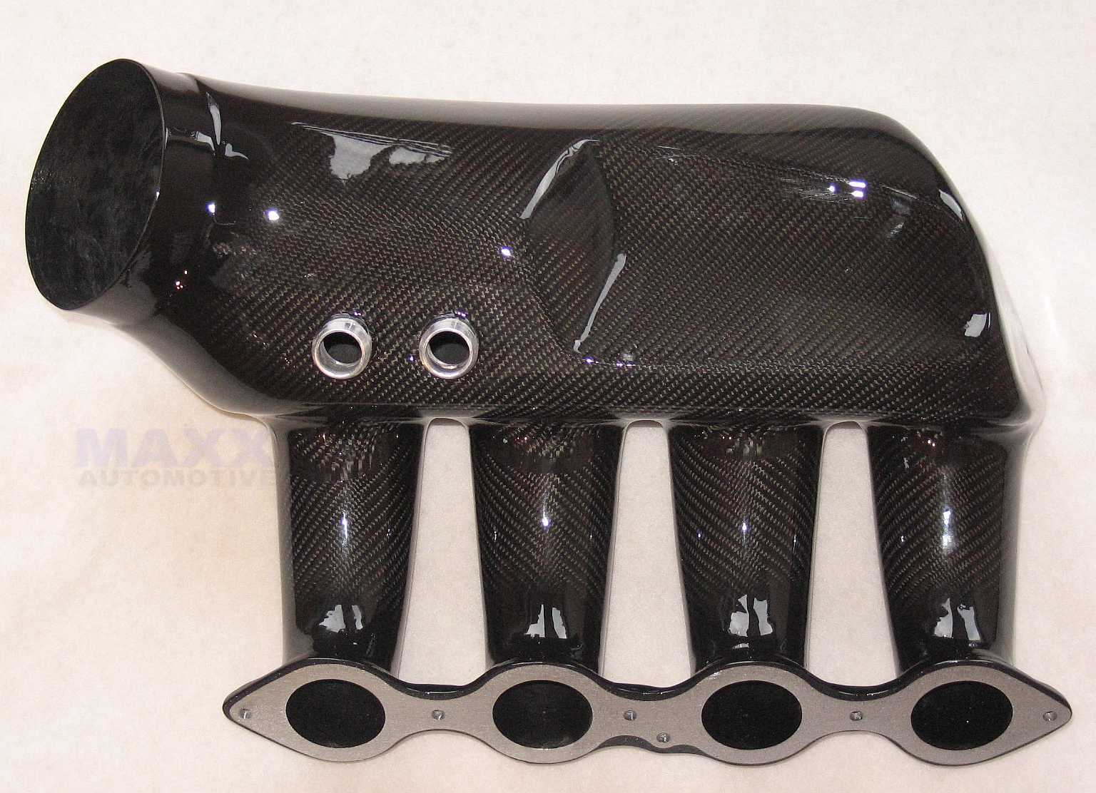

                        2015 group buy for carbon intake systems (aka CF airbox), currently in progress, production ending Feb. 28, 2015. These CF airboxes are hand made here...
