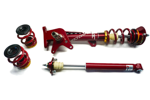

        adding to the options........
        Introducing our BRAND NEW and HIGHLY ANTICIPATED E30 M3 Fabricated Complete Coilover Suspension System!   The days of donor strut housings and strut tube modification are now behind us! There are ZERO cores required for this kit. No more searching for cores to send in for modification, this is a complete, standalone, d
            T
            i have kw v3 and they're good enough for me, but if I did it again I would get this for sure.
