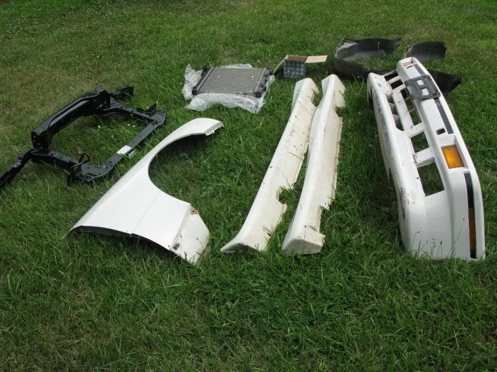

    Just want to get a feel for what this car is honestly worth as it sits. The parts pictured come with the car obviously.
    It has 98k original miles, supposedly it runs fine (even though i see no belts or an intake or fan or radiator in the pics), it has a clean title, although it seems to have been in an accident, and its a 1988.

    Do you know what type of "hit" it took? I must say I'm a real glutten for punishment when it comes to rebuilding/salvaging cars, but the front end damage doesn't look all that severe to me from the pics. You already have a new core support ready to install! :-) Have a good body shop do this work and make sure the car is within spec.
    Certainly looks like a project that many of us on this forum wouldn't be afraid to tackle. If the car is basically structurally sound and the undercarriage isn't rusted out, I'd say that car might have potential if you can get it cheap enough.
    You say the title is "clean"...not a salvage title?
    What about the condition of the engine? Any specifics? This is where you can easily get in way over your head...the engine work alone can cost more than the car is worth (i.e. $7,000+). I'd like to hear more about the engine. Maintenance records, etc?

      There is a fair amount of body work needing to be done to that front end. Check to make sure your frame hasn't been bent. You'll need a new radiator support. How is the wiring, was everything taken apart with car, or were wires and connectors cut?
      Find out how long its been sitting.... From the looks of the pullies its been sitting for a little while. Also inspect the rest of the car, remove trunk floor mats and look down in each corner to inspect for rust. I see some surface rust on the rear, so check all possible areas for other rust. Inspect all over V.I.N. tags and make sure they match.
      There seems to be good money in parts, but as a whole I prob wouldn't pay more than 5-6K for the car. If you can't turn the motor on and hear it idle/run/ or drive it you have to take the sellers word that the drive train is good.... You'll surely be pissed if you spend months and $$$ fixing the body just to find out the motor needs work as well.
      Seeing as how it needs serious front end work, ultimately it will never be worth as much as a sub 100K car without accident history. Don't buy in too high or you will quickly find out that for the amount of money it is going to cost to fix this car, you can buy one that has clean history and is ready to go.

        Really tear into this car and find out the condition of the car. Judging from the pics,
        you really look into the condition of the floor boards, cause there might be some
        rotting where the gas pedal is. Just be ready to spend a healthy amount of money
        on body work. You really need to find out about the condition of the motor cause
        that can get real pricey if it indeed needs a rebuild.
        Also check the wiring. It appears that an aftermarket sound system was in the car
        at one point judging by the hack job done on those red wires running through the
        trunk. Figuring what the previous owner did with the wiring could be cumbersome.
        Please don't enter this project if you think $5k would cut it, cause you'll be in for a
        rude awakening and it won't be long before this car is back on the market. Do your
        homework and determine if this is a project you can tackle with some money in the
        bank to throw at it.

            No expert in these matters of body repairs, but the ABS unit looks to be sitting at a strange angle, so the inner wing/ front leg not all bend and distorted?

              I would buy this car just from the pictures for around $3000. That being said if there is no to minimal rust and the the frame is straight and the engine turns perhaps even 4000.00. As all have said before if the engine has problems than it's not a good deal. But that's the chance you are taking considering a car like this. A bit of a roll of the dice. Can you put a fresh battery in it and spin the engine for a compression test at least?

                Here are the details I got from the owner.
                He bought the car in this condition 2 years ago. Once a month he pulls the plugs, squirts oil in the cylinder, and cranks the motor over by hand a few times.
                He says it ran when he got it, and he started tearing it down to repair. He was distracted by 5 other BMW projects going on (e30M3 race car, a rally e36, and some others).
                The title is clean, in hand, no salvage or anything on it.
                He had the car checked out by a body shop when he got it, and the frame was straight as an arrow.
                Whatever hit the car, hit just above the bumper. The owner had plans that fell through, and sold it. The guy I am getting it from had similar plans, but was tied up on other BMW's.
                I'll be taking his word that the engine runs and the trans isn't messed up.
                The front is taken apart so far because he started to do that when I said I was interested. He pulled a bunch of stuff off so I could get to the core support easily.
                I'd like to replace the core support, get a hood and a fender, then title and tag the car so I can drive it around.
