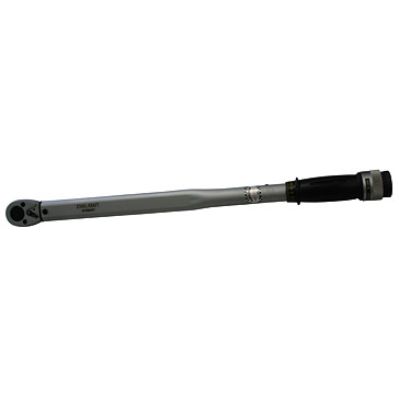

    Of course all the inexpensive and arguably more accurate (but less sexy) beam style torque wrenches can torque in either direction.
    All my Snap-On torque wrenches will ratchet either way....so I assumed they would torque either way....but I have never tried it. Am I mistaken?

    It's a Sthal Kraft torque wrench like this
    Ihr kompetenter Lieferant fĂr qualitativ hochwertige Werkzeuge rund um den Werkstatt-, Industrie- und Handwerkerbedarf.
    In fact, the wrench has clockwise and counterclockwise direction, but just the clockwise sense has the automatic release "click" signal.
    So, I can check the torque only on the RH thread.
