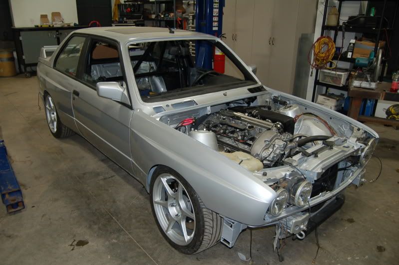

    quick update.
    electrical done. all custom chassis harness. dash, gauges, engine management, lights, abs, wipers, pwindows........ everythign done (except for a small amount of engine management parts im waiting for. )
    suspension done. (including new sway bar and mounting.)
    brakes done, bled, need to finish mounting bias dial.
    anyways, back in the saddle. enjoy the pics. jason

      wow. s54. impressive. nice swaybars too.

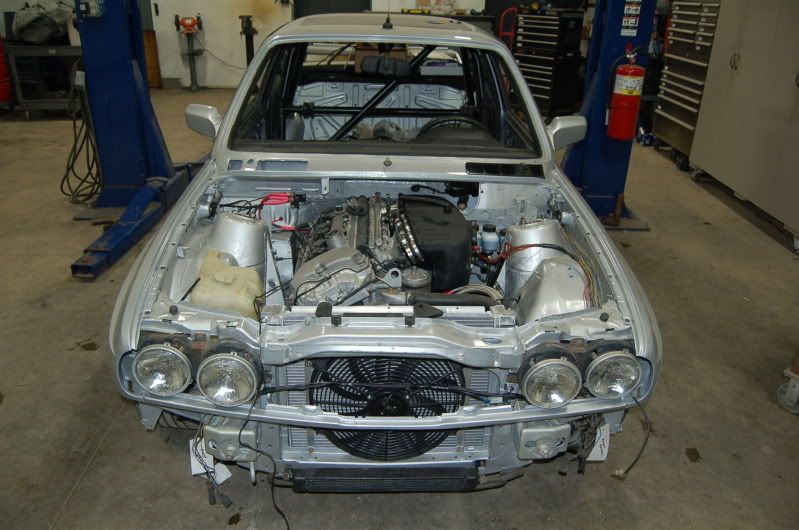

              hood mounted.
              bumper mounted.
              brake ducts mocked up.
              slowly but surely......
