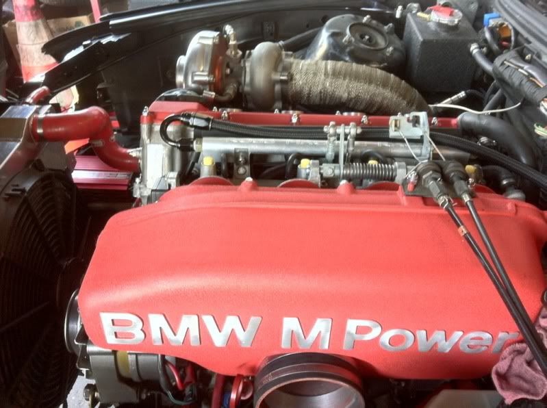

My M3 build pics (pre turbo)
  • Party at Castro's!!! I think we were celebrating smoking the place out (CO not THC)... Well as progress goes there were a lot of little issues so "while we were in there" we rewired the eurolights eliminating two feeble hack job attempts, relocated my MSD DIS-2 setup, IAT, and misc. wiring... PITA
    So close I can taste it... Nah that's just smoke residue :-/

                • Aaron, I used Permatex Head Gasket Sealant 80065 #99 High Tack Spray-A-Gasket Sealant the equivalent of Loctite 3020. I sprayed between every layer of the MLS gasket (3 pcs.) twice then allowed it to setup overnight under pressure of the head then sprayed the outside of the gasket with two layers then the block surface... so almost the whole can.
                  Well the car is running thanks to Chris & Chris pulling a whammy miracle at the last minute dialed in a call to Derrick to tune the MegaSquirt...
                  Let's just say troubleshooting it was a PITA! The Low-Z injectors with resistor box ran but tuning with them was a nightmare, so since that was the only part of the equation that had changed in this metamorphosis we decided to revert to a set of High-Z 50lb./hr. injectors and voila it was running like a normal S14! But Murphy's Law... all of a sudden a vacuum leak appears at the joint of the throttle bodies, blame it on the boost All-in-all a very productive day except 4.5 hours of driving from the IE-Hollywood in Friday traffic :shit:

                        • Basically the injectors keep dumping fuel... At first I was running Low-Z 750cc with inline resistors so I assumed it was the size. I pulled the injectors & resistors and installed a set of 550cc High-Z a little better the turbo spooling slightly but still couldn't get it to idle right and it started to sound like a Subie... Now a little worried we went down to orange tops... Same thing. So we went through the whole thing again measuring shims, checking for bent valves, fuel & spark, coils wires, compression I'm just tired... If someone had a JimStim and could bench test this my MS I would know whether to buy a new MS3 and use the 3.57 board from my current box if it's not damaged. I can't call it...
                          • Have you tried test mode with the injectors and plugs pulled to make sure they're firing as expected? To test, I start by pulling the fuel rail, still attached to injectors and fuel supply, put newspaper underneath, and fire each injector channel through the test mode so I can see each one firing with my own eyes to make sure they work. Then I repeat with spark plugs pulled. Wrap a wire around the base of the plug, ground it, then fire each ignition channel to see the plugs firing.
                            Have you posted your issue up on the MSExtra forums yet with your MSQ? That's how I've debugged most of my issues.
                            Jimstim is good to have, and cheap, but you can achieve much of the same testing using the test mode...
                            Good luck, MS is certainly more finicky to get running, but I've found it great once I got the initial bugs worked out. Plus, even if you do switch to ViPec, you want to be able to say that the unit works 100% so you get more of your investment back...
