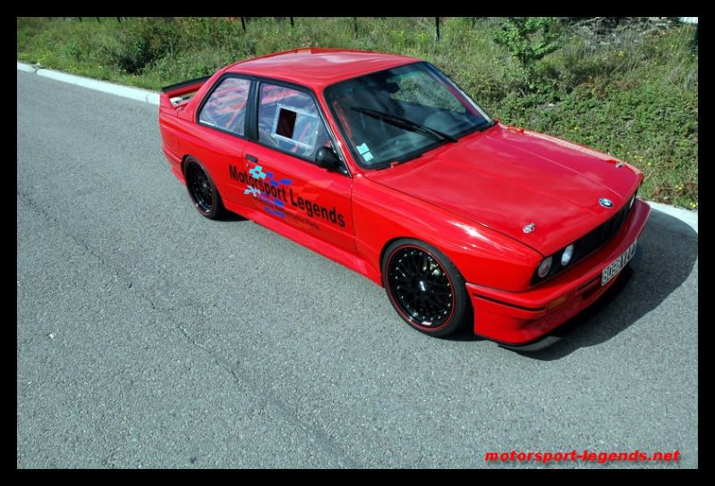

    Hello,
    A quick shooting of the first project i build for a friend.
    I'll post more picts later from the beginning of the project.

            VERY, VERY nice indeed Roland. I wouldn't expect nothing worse from you. I got 2 questions for you. What was the set-up used to fit the S50 (it looks like it seat quite aft) and what's the brake set-up you used?

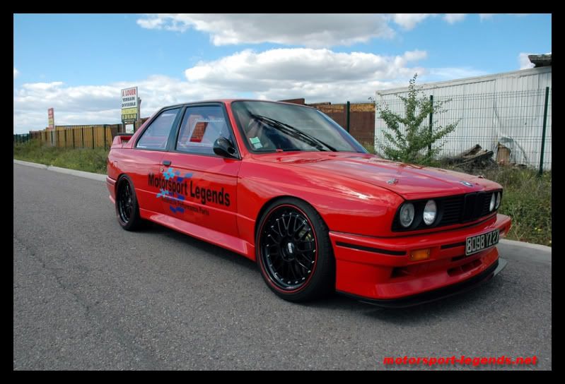

              I used e28 motor mount bushings with the standard e36 motor Supporting brackets.
              The complete harness is along the shell carrier, for a clean look.
              Front brakes:
              brembo granturismo rotors with Brembo 4 pistons calipers (subaru STI) and pagid pads
              rear brakes:
              Z3M zimmermann rotors with brembo 4 pistons calipers (from the granturismo front kit)

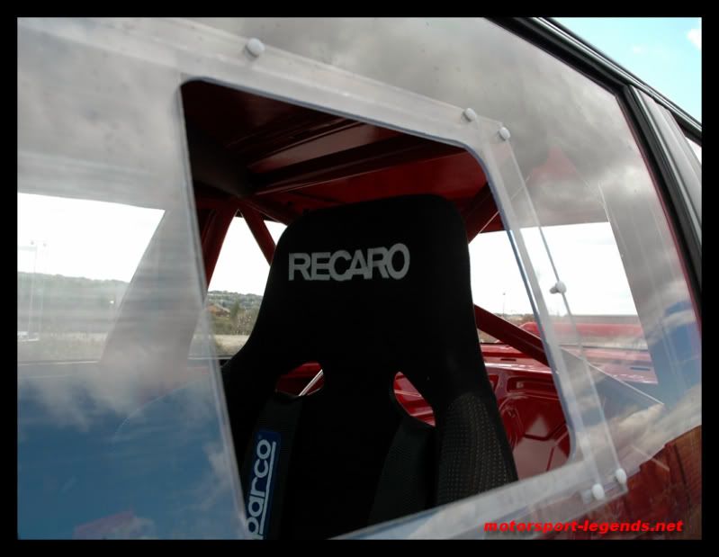

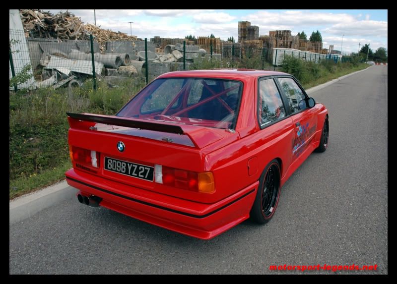

                Very nice work and great attention to details. Uber clean engine bay. Good work. Nonetheless I couldn't help notice a few screw ups.
                - The pick-up point for the shoulder belts is way too low to be safe. Angle should be 90 with the torso, within 20. Under impact, the shoulder belts will compress you spine the way they are currently installed... Not good. There must be a reason if FIA has established standards.
                - The hydraulic handbrake has a bad design. The travel of the pick-up point for the MC will go much too high and not inline with the travel of the piston. Not tangentiel at all. Therefore some of the force used to pull the lever will be lost...
                - The cage looks good, but the sidebars are of no use at all. They won't protect you. They won't stiffen the shell at all as there's no triangulation. You might as well remove them and it will make no difference.
                Keep up the good work.
                  Thanks Lee.
                  It's not a race car, but street one
                  -The handbrake is sold like this, and i have no problems with it.
                  -The rollcage is a SPARCO, i don't built it...
