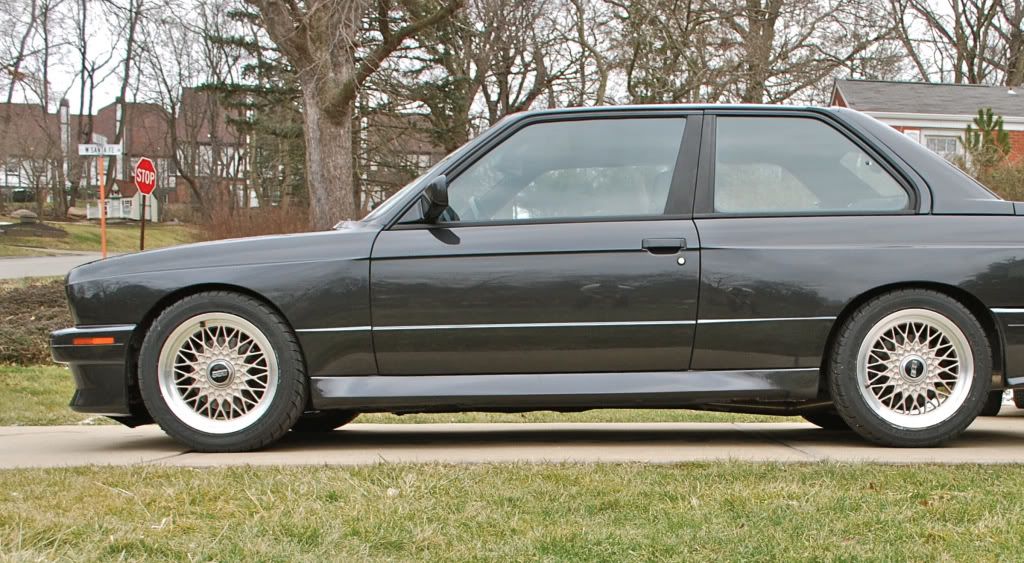

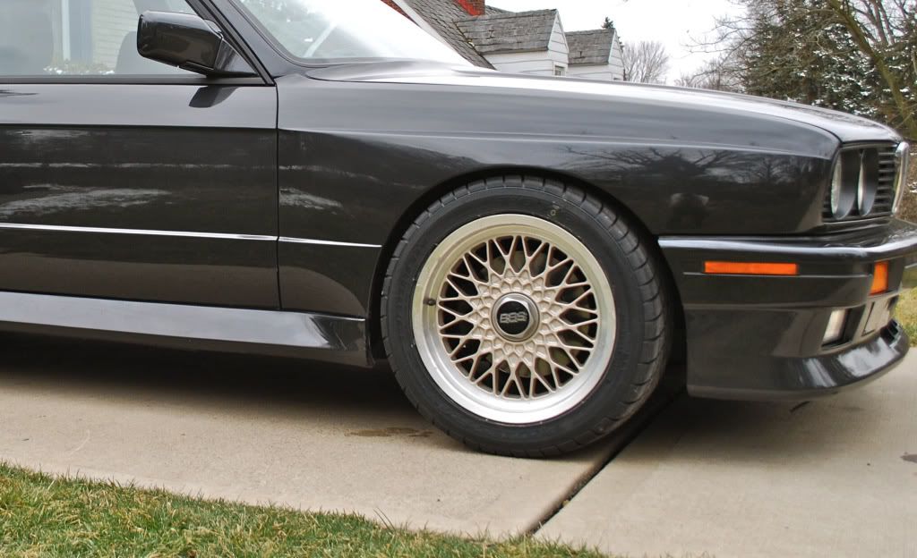

    I have an issue with my front driver tire getting cut up at just above 3 o'clock on the fender's edge when weight is transferred to the driver side like when backing into my driveway off a incline road. When this happens, I can only turn my 225/45/16 tires to the left about 40 degrees before the lip cuts into the contact patch (not sidewall), maybe 3mm deep at the most. Again, this is my right only, left tire never rubs. I had an alignment 20 miles ago immediately after they put the new tires, rims, and VAC 19mm RCS on.
    Anyone know what I can do other than go with skinnier tires or change wheels to have a higher offset? Would camber plates be helpful to shift the front wheels forward, which would center them in the wheel wells more? Do I need coilovers to have camber plates though? Sorry, I am not well versed in suspension geometry. I suppose I could also put taller or stiffer springs up front as well, any recommendations? I'd rather not roll the fender, and think it would still rub if I did, just not cut.
    I have stock shocks with Eibach lowering springs, rate unknown as installed by the previous owner. I also have tree house cabs and the tires are toyo R1Rs on BBS RG 005 ET 18.

      From your pics it looks like you can be best served by installing the offset control arm bushings......this will add caster and move the wheels more forward in the wheelwell.
      That would be the easiest and most inexpensive route.

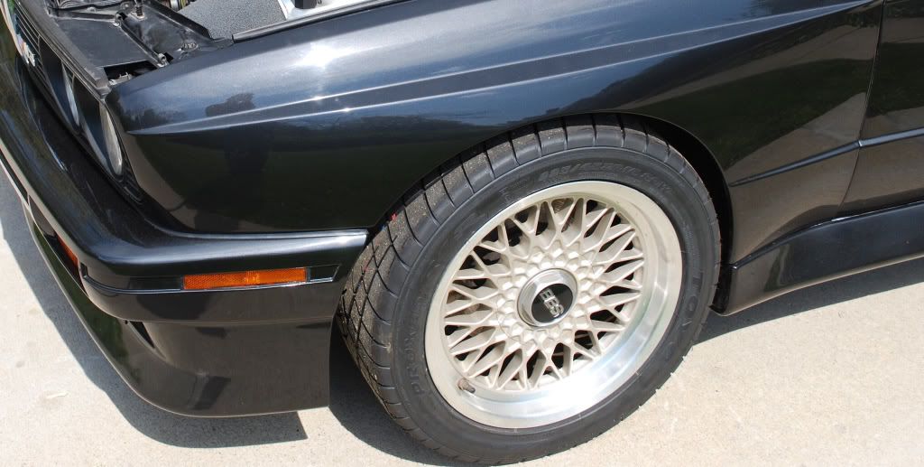

                      here is my old set up 225/45/16 square no rubbing perfect fit Hr sport springs.16 x 7.5" et 20, 16 x 8.5" et 24
                      I have dyslexia so most the time my writing and spelling looks okay to me
                        It'd be cool if I could see the front wheel. Since my offset is only 2mm lower than yours, I think the difference is the enormous contact patch of my R1Rs. They are very square and wider than the 7.5" rim. According to the spec sheet, the overall width is 9.0" and contact patch is 8.3". Compared to stock 205/55/15 Yoko S drives, that is a full 1" wider contact patch. Combine that with an inch less offset and slice!

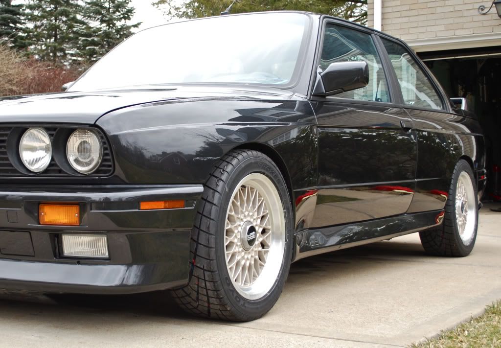

                          Here better shot the front for you.Bet this would solve your problem http://www.discountedwheelwarehouse....02106&pID=4989
                            I don't need to see the front of the car, just the front tire's relation to the fender, which I still can't see. I think 215/40/16 is too extreme and would lower the oil pan so much that I'd soon have a bigger problem than I do now. 215/45/16 might be the ticket though slimming my sidewall down 1cm as well as tapering in better.
